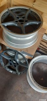

Had mine done just last week.
£400, including two different colours (the inner barrel is black) and yes, split. No problems.

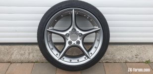

Ok, another question...
Found these images, I want to ask the OP what colour of bronze he used. Any ideas?

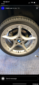

Just had my 108s split and refurbed by Triple S over in Bingley (West Yorkshire). Done a fantastic job. 5 bolts sheared so I just had some spares posted out to them from ebay and job's a good'un. Get the car back tomorrow so will post more images then. I opted for a standard looking finish, although the outer rim is no longer polished.
