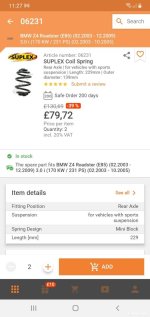

I'm looking to order some shocks and springs, looking at Bilstein B8 shocks and Suplex springs (as they seem to have a good review on here) and B12 is out of stock on Autodoc. It is a 2006 with the sports suspension, on Autodoc there are 2 fronts and 2 rears listed. 06247 and 06248 with the first being 9 mill longer. The rears are 06230 and 06231 but seem to have the same length. I'm inclined to get the 9mm longer ones. The Suplex online catalogue lists both fitted but the 06248/06231 numbers as "with opts". Anyone know the difference or which they ordered? Not looking to go lower than what I have as it seems to sit nicely, however as nearing 140k probably due a freshen up.
