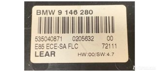

This is mine:
and here's one on ebay:
Almost identical numbers. I'm tempted to go for it.

This is mine:
It was a "Buy it Now" for £45 or "Make an Offer". So I made an offer for £40 .....and it was accepted! Free postage too.
I think that all things considered it was well worth a punt, and if it doesn't solve the lighting problems it might at least go some way to eliminating some of the causes.
