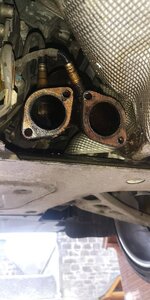

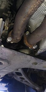

The next thing I tackled was slightly more involving.. the root issue i was trying to solve was the infamous "clunking" from the rear diff when changing drive direction or letting the clutch out in gear. As you probably all know, this involved removing the exhaust which meant I would need to tackle the nightmare job of getting the exhaust studs out. Ha....

Many drill bits later, i found the best method was to use a Dremel with cutting discs on it to cut the studs off, then separate the exhaust and remove it, with the remaining stud on the manifold side drill a pilot hole through it then work up one size of drill bit at a time until you can get it out. Once i'd done the first one, the rest were a lot easier. Use plenty of cutting fluid otherwise it'll just destroy drill bits. My drill took a battering and it's still got cutting fluid coming out of it today!

Then chucked the exhaust back on with some new fixings up front and some new OEM rubber hangers and BMW gaskets (how are these so expensive?!?!).
