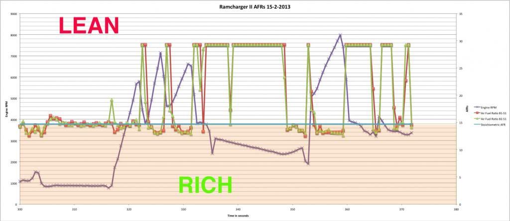

Here's another graph showing the Air-Fuel Ratios that I recorded with the Ramcharger II mod. The blue line represents the stoichiometric value of 14.7 : 1 (air:petrol). When the engine is idling (305secs - 317secs) the AFR is at stoichiometric levels and when the car accelerates in 1st gear (317secs) the AFR immediately drops (i.e. the AFR becomes richer) but then it returns to stoichiometric values. This seems to be written into the ECU software as part of the traction control system to prevent wheel spin when accelerating from rest. When the car accelerates in 2nd and 3rd gears (at 323secs and 327secs, respectively) the AFR drops to around 13:1 (i.e. fuel richens). On lifting-off and decelerating (332secs - 348secs) the throttles close to their minimum opening and the AFRs lean right out to a recorded value of 29.26 : 1 (stoich x 2) to maintain engine tick-over. The same scenario occurs when my Z4MC is in OEM state, therefore, I've concluded that the ECU can easily accommodate the increased mass airflow that my Ramcharger mod is designed to achieve without any need for remapping.
Some have suggested that increasing the airflow will cause the AFR to become lean. Lean AFR's under WOT will cause "knock" and engine damage but, clearly, the evidence provided by the ECU to my datalogger is that this does not happen and that the OEM fuel maps are sufficiently "broad" to accommodate changes in the order that I'm able to achieve with an improved ram intake. 8)

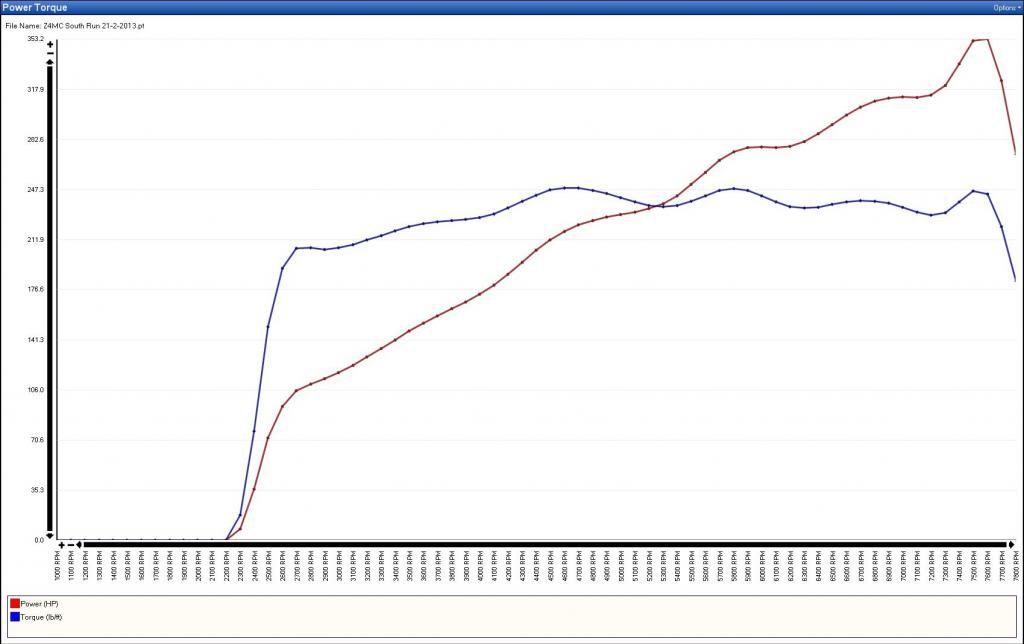

I've done a further mod to the silencers and refitted them to the car and since the roads are still dry, I went out this afternoon and did some more datalogging. Below is a screenshot of one of the dyno runs from this afternoon displayed in the PC software which comes with the DashDyno. The car was fitted with the Ramcharger II and gutted silencers MkII. There was a cross wind of around 15mph
Below is the same dyno run, saved as a .csv file and a graph from it in Excel.
The fitting of the gutted silencers seems to have reduced the dip and spike in torque that had been appearing in earlier dyno plots with the Ramcharger II in conjunction with OEM silencers. This has also made the torque curve much flatter and where the peak torque at 4,600rpm is not much greater than the torque that occurs at 7600rpm in this graph. The peak torque has increased by 2.4 ft/lbs, but because there's no sudden spike in torque at around 7500rpm, the peak power is less than shown with the Ramcharger II and OEM silencer combo. The long and flat torque plot has always been my aim, and so I think I've achieved what I set out to do.
Interestingly, by fitting the gutted silencers with Ramcharger II, I've also seen a further small increase in maximum airflow through the MAF, so that with the Ramcharger II and gutted silencer combo, there is now an 11.39% increase in maximum airflow above what flows in OEM format. I've also managed to get my Z4MC to have a slightly higher maximum airflow than I've been able to achieve with my Z3MC due to the different layouts between the cars.
As an aftermarket solution, I think that I've taken this about as far as is practical although I think that there are a few minor gains to be had from the silencers. As we all know the Z4M is no slouch, but my Z4MC now feels even more responsive and livelier. It's also much noisier with crackles and pops from the silencers and there's much more "theatre" to it. :D
