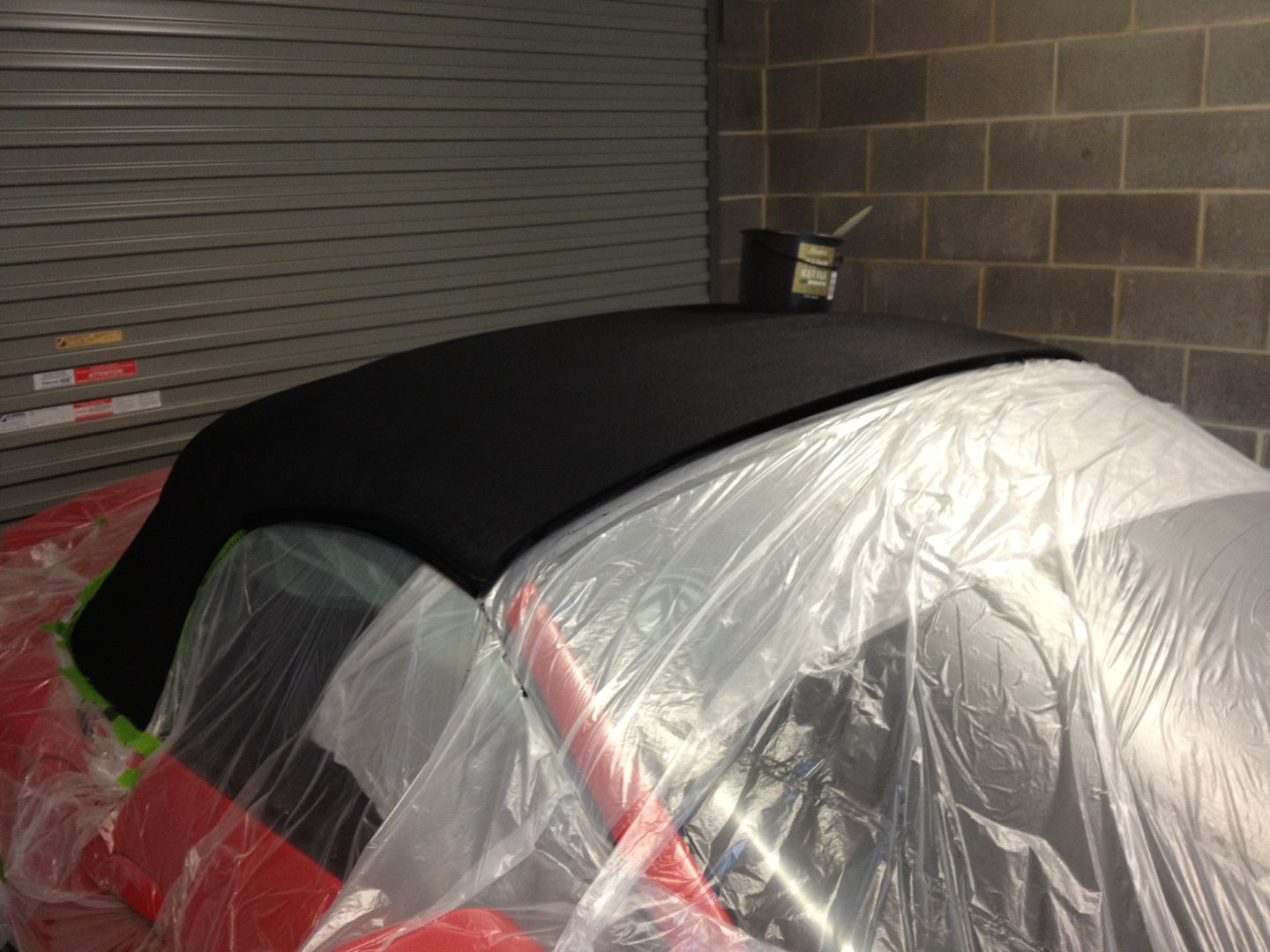

there was a post on here were a member did some treatment to his roof and he used one of those disposable plastic decorating sheets wit good effect across the screen and rear. I did similar after reading the thread. Just remember that the doors need to open and the windows drop slightly when they do so you cant tape it all up real tight :) like i did.
That might have been me... I used Renovo for recolouring, worked fine but doesn't address the wear (shiny) marks.
