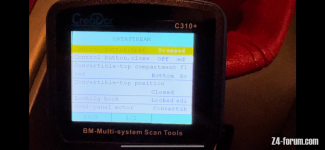

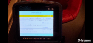

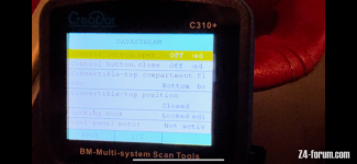

  • Checked the micro switch for parcel shelf, also looked fine and light was red rather than orange, however when reading the data stream on code reader, boot shelf switches from “bottom” to “not at bottom” after unlatching, but we could see it working on screen as we toggled manually.
So I’m slightly stumped, does anybody have any idea? Issues started after leaving the boot slightly opened, so was wet although dried out when I noticed (may be red herring!)
I’ve got a creator 310+ code reader, but not fully sure what menus/sections/sensors I should be looking at to try to diagnose, I’ve got a number of photos before during & after pressing the open button of screen but I have plenty more of the other screens before/after if useful (different menu sections, will attach in second post) - hope they may be useful for those more technically minded than me!

Data stream from code reader
Before
During
After
