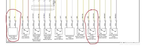

The wires are different colours so different part numbers, not sure if both are Hall or one is Mechanical switch.
Need check wiring diag.

My failed was the hall switch, which is what Foxwell reader said.
The other is microswitch.
I assume wire lengths might be different.
