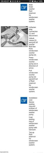

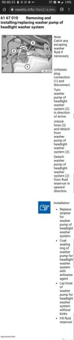

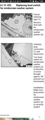

Screenshots below in order of removal. For info, I managed to remove the pumps from the tank without disconnecting the hoses.
