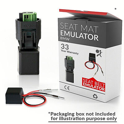

Nothing extra for the driver's side, but I put a spare, genuine passenger occupancy sensor mat (52107053946 which is no longer available from BMW) under the cushions on the passenger side (mine is an early model without the passenger airbag deactivation switch). The alternative is one of those ebay occupancy emulators.
For example:
