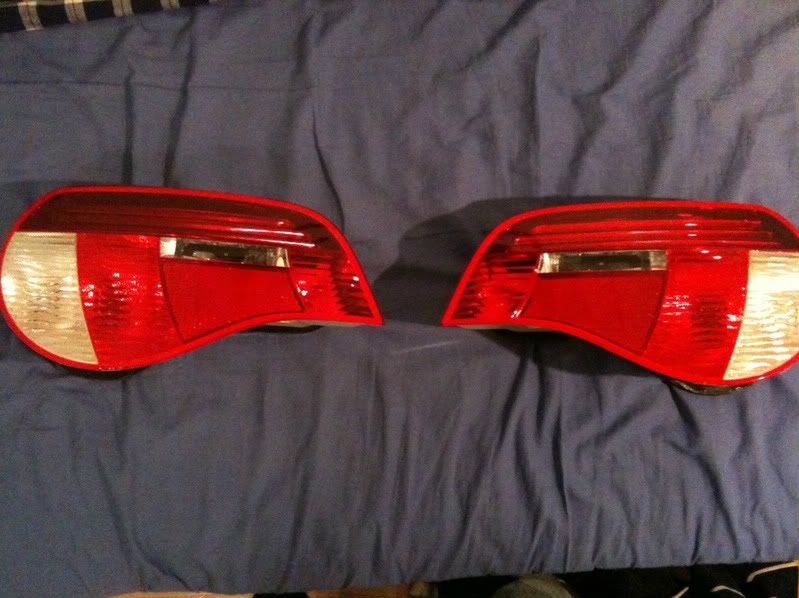

lights arrived today.
I gave them a go, and everything worked great after coding (HUGE thanks to nahodo) :thumbsup:
Correct wiring clusters for me was

After months of searching and missing out on rearfaclift lights on ebay, I managed to pickup a set for £110
They were a tad scratched and dull but i used a restorer to get them back to a near new condition

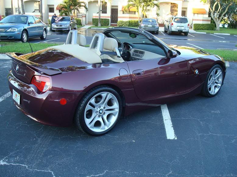

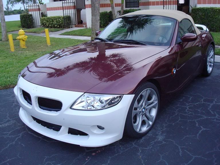

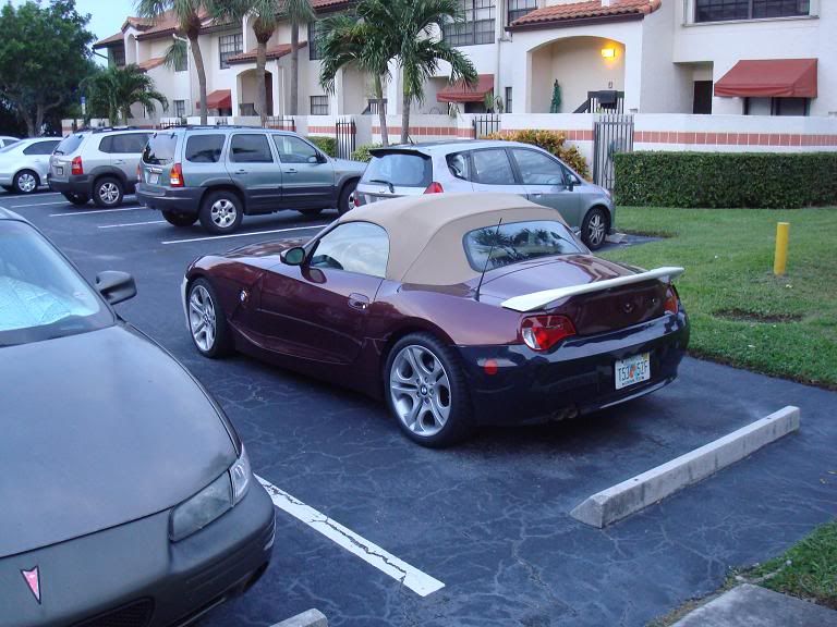

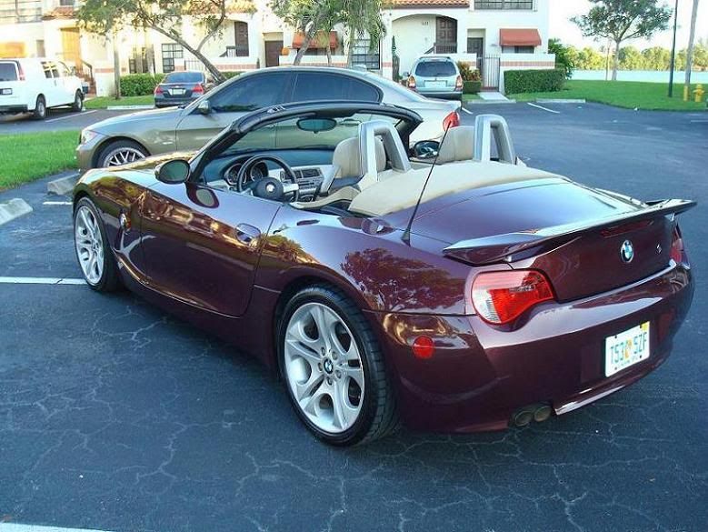

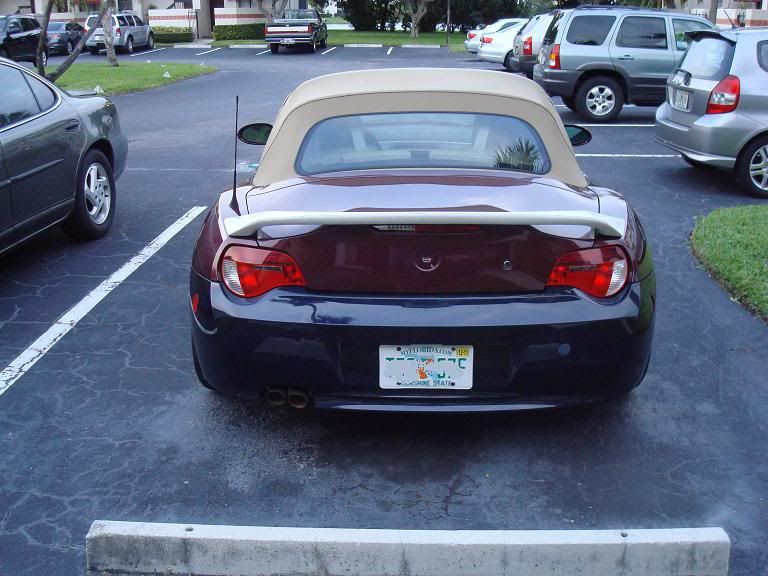

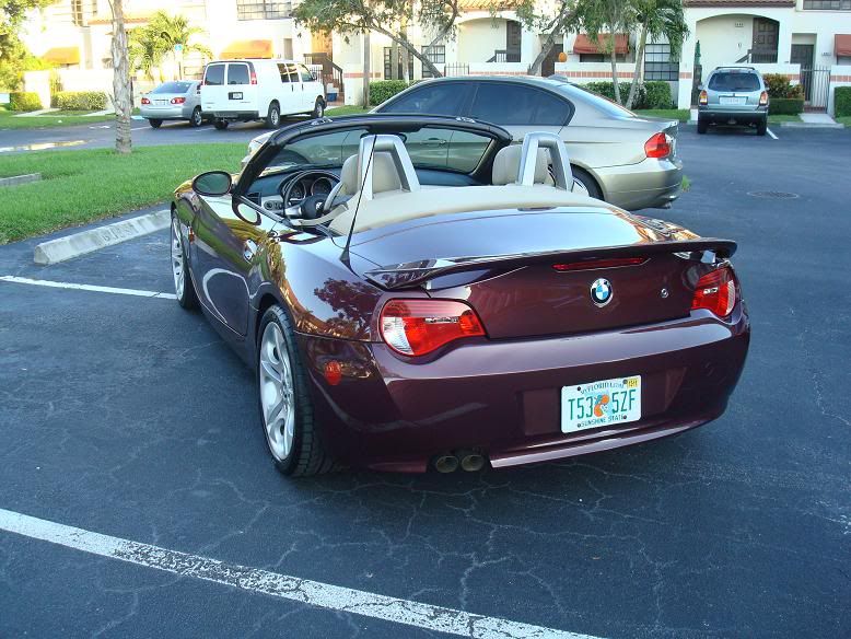

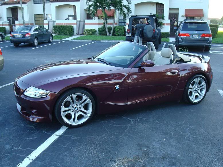

A few teaser shots before I go for paint. I've been doing all of the pre fitting work myself.
:o
May seem a daft question but how do you open the boot? It looks from the pictures that the rear spoiler is attached to the rear wings or is it just me?
Personally I don't like the rear spoiler. I think it spoils the lines of the car... but each to there own :D
Some say, that rear spoliers are only put on certain types of cars to give you something to easily push when they break down... :poke:
I'll reseve final judgement once it's all sprayed up, though +1 for wouldn't have one fitted myself
It does look like that spoiler attaches to the wings?! Either that or it is somehow attached to the middle?
The spoiler is a matter of preference. Personally the only exterior design element of the Z4 that has always bothered me is the duck tail spoiler. The Hamann spoiler is attached to pedestals on each edge of the trunk lid. They are more visible here because they are silver and contrast against the color of the car.
billygilly said:
Ranski tell me how this goes as I haven't got the gear to code mine
Find an independent BMW shop with an Autologic tool. Common in the UK from what I understand becuase it's made in the UK. My shop coded for free while the paint work was being done.
