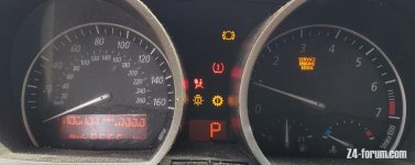

So, I just aquired this Z4, and I have a host of problems (I posted to the new user thread).
The big stumbling block is that I cannot talk to the computer with an OBD2 scanner to try and clear codes.
The dashboard LCDs are flakey looking. when I first turn the key the trip meter says -43200 with missing segments. When started you see the above picture.
I cannot get it to talk to two different OBD2 scanners. voltage is 12.1 at the fuse panel when the car is off.
