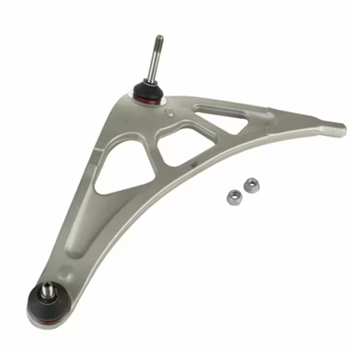

Thoughts?
GuidoK said:There are no other bushings on the front axle.....so....
Piper1 said:Correct me if I'm wrong but 2 of those arrowed in the pic are ball joints built in to the control arm that powerflex doesn't make a bush to replace.
https://www.powerflexusa.com/shop/category/bmw-z-series-z4-2003-2008-1824
jamie_z4 said:If your replacing the one Bush with power flex (a solid Bush) but leaving all the other bushes oem it'll eccenuate the wear in all the other bushes on the front axle and make it feel a bit loose after a while imo so stick with meyle
jamie_z4 said:GuidoK said:There are no other bushings on the front axle.....so....
Err, there are 3 bushings in this picture alone... if youd taken the time to read my post, i said if you replace one of the bushings
GuidoK said:jamie_z4 said:GuidoK said:There are no other bushings on the front axle.....so....
Those other 'bushings' aren't bushings at all but ball joints. Like I said, the only one that is a bushing, is the rear one.
Per side there is only 1 bushing in the control arm.
Also there is no 'accentuation effect' of wear. Every bit of play either in the rear bushing or in the 2 front ball joints gets added to the total amount of play the wheel experiences. This is not a reason to choose for meyle over powerflex.
And if any of the ball joints exibits play, its time to replace the complete control arm. A ball joint shouldn't have any play at all. If it has, it means the inner liner of the balljoint is shot.
