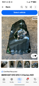

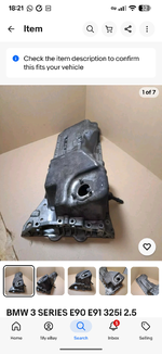

I recon you could probably get an automatic sump to a manual car. I'd not want to proceed without checking further, but the difference seems to be by the oil sensor, where it bolts up near the bell housing. I reckon with the longer bolts, you'd probably be fine.
Black steel is manual. Silver alloy is auto
If the capacity is the same or not, I don't know (but I'd expect it is?)
View attachment 296796View attachment 296797
The auto sump apparently has a few differences that prevent it from pushing up to the housing. Potential for it to fit, but only with some fabrication and adjustments that i don't have the skills for (and if my usual indy does, i don't think they have the appetite for).
I will go second hand if needed, but hoping for a direct replacement - 2nd hand or aftermarket - that fits without needing to bodge it.
It's odd that there seems to be more than one aftermarket option for the auto out there, but seemingly none for the manual.
Some years ago a forum member with a manual E85 3.0Si had a sump that started leaking due to corrosion and he struggled to find a replacement. He ended up finding an alloy one, but sadly I don't know where.
According to realoem E8* 1 Series and E9* 3 Series with the N52 engine use the same part so that might help widen your search. Good luck anyway. :thumbsup:
