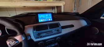

I think ths is best solution for z4 E85 how i change the original radio for other one with new function.
:) i have still lot of works with my z4...is still winter in CZ :)
is from china also - JMCQ
6GB ROM - 128 MB RAM
- Andriod 11 - Support OBD2 to on screen torqu, rpm etc. , and screen for BMW ;)
- 8 core - 48EQ
- wifi 5 - BT
- Andriod auto - Apple - Mirror llink
- Support rear and front camera
- LCD QLED
- ext GPS
- ext SIM 4G
- ext mic
- support steering wheel function
- 2x ext USB
2DIN is better solution but i want have original status .......and 1DNI is for me better solution

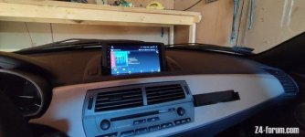

Hi, today I did the test.
Iam not satisfied with this product :( Issue is in the Connect2S adapter, exactly he provides what i dont want. Sound is ony trought radio whitout ext. amplifier and through it whitout 2 Subwoofer :thumbsdown: :thumbsdown: :thumbsdown:
I wrote a ticket to Connect2S and my AHIFI shop what are the next steps.
Otherwise Radio is really good, have quick reaction boot 5sec, very excellent product. HF it goes whitout ex. mic whit verry good sound. Waze GPS, OBD mini whit BT, wirless AplleCarplay, amzaing is EQ 48 and settings and also goes the multifuntion from steering wheel.
This product is amazing and shifts Z4 to another level to 21 Century.
And i see the diference betwwen original connectors and the connectors from Connect2S
