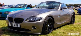

A few photos of the supercharger kit, stages of the install, finished product etc.... to whet your appetite
