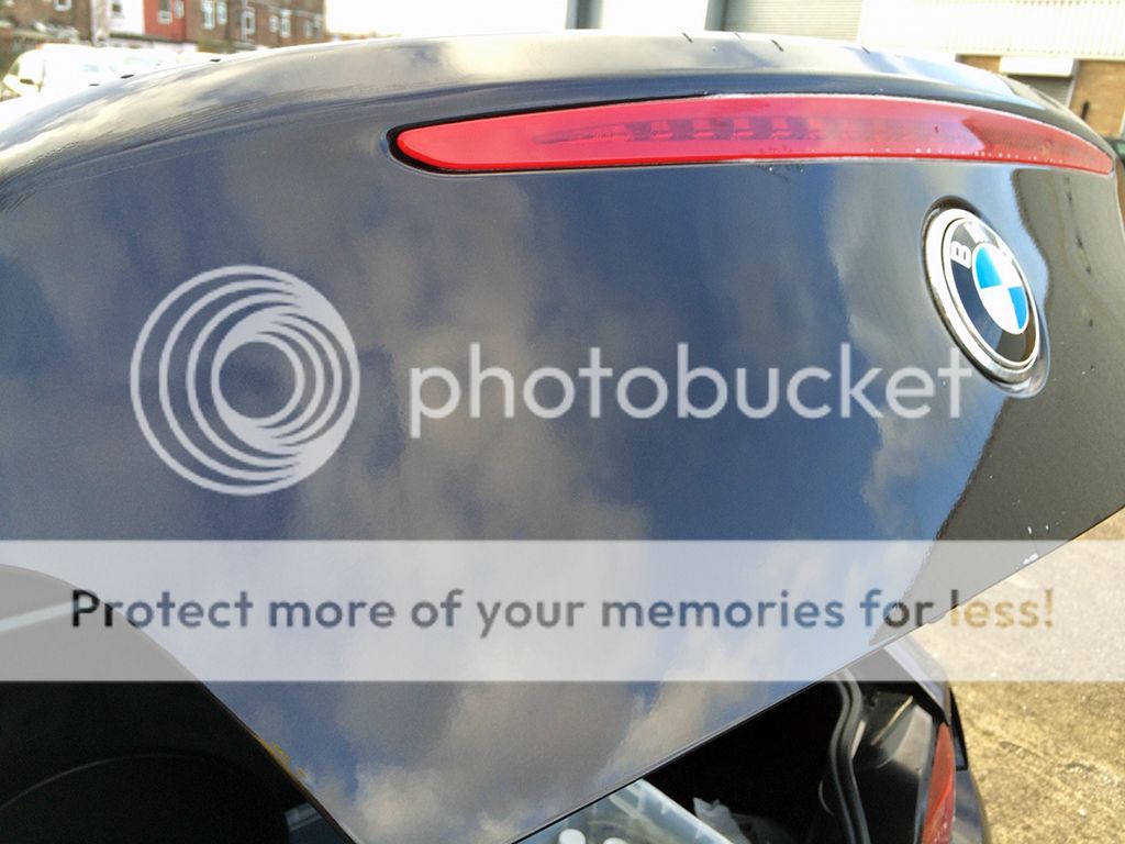

For Job number three this weekend, I've set about getting rid of the 3.0si badges from the side and the Z4 badge from the rear hatch :)
Firstly - I washed the area where the badge was to get as much dirt off the paint as possible
The next task was to remove the badges themselves - I did this using dental floss as a cheesewire with a gentle sawing motion to cut through the adhesive.
I'd recommend not to pull the badge at any point as you could scratch or even dent your bodywork with the sharp edges of the plastic badge.
You'll be left with this mess...
Try to peal as much of it as you can by hand, just be carefull with your fingernails on the paint
I then removed the glue using 'Tardis' which is a valeting industry glue and tar remover
*Thanks go to my valeting colleague 'Jimmy the Hoover' for the loan of this stuff!*
Once all the glue was gone, I gave the car a couple of coats of Autoglym Paint renovator and a coat of Super Resin Polish.
The same treatment for the rear, A quick wash to begin.
A quick shot with the bulk of the adhesive gone
All polished up nicely!
And finally a photo of the car :)
