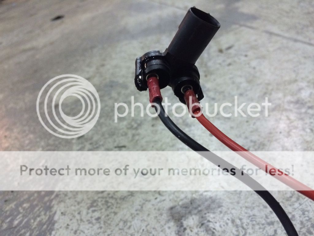

So... A couple of my colleagues were staying behind at in the workshop tonight, so I took the opportunity to make my Z4 horny again!
Having ordered up a pair of so called 'Direct replacement horns' from Euro carparts, I found that they weren't exactly a direct replacement, but soon figured out a way to fit them on without chopping up the original wiring harness.
So, As you can see on the original horn, there's an electical contact designed to fit the O.E plug. Upon removal of this contact from the horn housing, You're greeted with something that can be used for a nice custom loom!
This 'Micky Mouse' shaped electical contact has two sockets inside it which fit the red 'bullet' connectors a treat!
Before going any further at this point, I plugged my new looms in and got a colleague to press the horn button whilst I checked with a multi-meter for voltage.
All was good, so now ready to fit!
Attached the horn to it's original bracket and bolted back up in position (this time with the horns facing away from the front of the car, so they don't drown again!!)
Now bolted up into position, covers re-fitted, tested and all working perfectly! Very happy that this didn't end up being a nasty job involving more intricate wiring.
