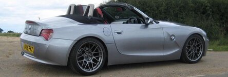

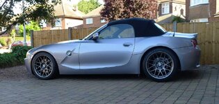

They arrived today and fit perfectly with no spacers required to clear the AP Brakes. I Think they look awesome, others will prefer the 19" CSLs but the car definitely drives better on 18s.
I took some quick pics, apologies for the poor quality:
Your car setup is awesome, the apex wheels are on my wish list of mods to do to my M when i get it over the winter.
Thanks buddy, has taken me a long time to get it where it is. After over 5 years of ownership and fettling with the handling characteristics have I only just thought 'hmmmm - maybe more power....'

Have been tracking her on the OEM 18s with Federal RSR track tyres, definitely the way to go ;-).

don..... that looks incredible. nothing more to add. PERFECT, and dat red doeeeeee........ HOT.
Thanks for the kind words chaps.
The car drives soooo much better on these lightweight 18s I do wonder if I will ever bother putting the CSLs back on... And at roughy £100 a corner for these Federal RSRs it might even end up saving me money.
Might even try the Nankang NS2R next too :-)
