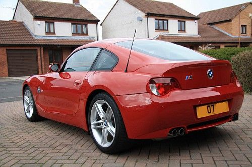

Front end same cars & the coupe is on standard springs but 20mm spacers on rear/10mm front :wink:
Widen the stance fills the arches which in turn can give a lowered appearance :?
Pics also can make a car look high or low
2 pics of my car / one shows arch gap over tyre as Crackers , others like its on Eibachs :?

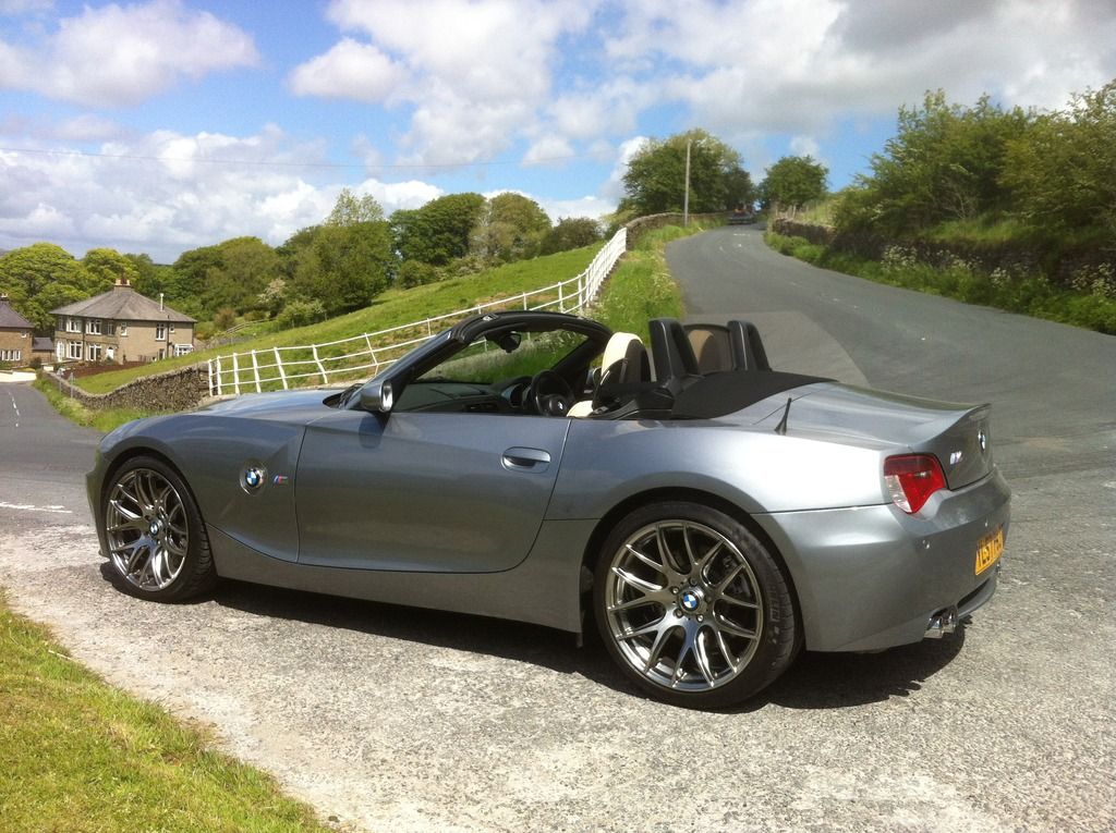

Here you go 225/40 19 and 255/35 19 on my CS rims (so 8" and 9 1/2"). I found the ride to be not so far off the ride on the oem 18s. My car on the right here with eibach springs compared to a stock on the left.
Looks pretty decent, i was wondering if the extra shoulder height would make it look a little over tyred but it seems pretty good in that respect. Probably a better solution for those who don't want to or can't lower the car.
