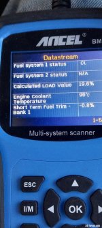

Most recently, we found a burnt O2 sensor and replaced it and that finally got rid of the super rough idle. However the service engine light keeps coming on randomly every 20-30 miles after each time I reset it to see if it will come back. When I get the light, the car doesn't feel like it’s knocking or misfiring and it drives perfectly normal. Usually, the codes are only P0174 - System too lean bank 2, however twice now it has given me P0300 (Random/Multiple Cylinder Misfire detected), P0303 (Misfire Cylinder 3 Detected) and P0305 (Misfire Cylynder 5 Detected) as well (out of the 6 times that I have gotten a light). What should I look at next?
The car currently drives extremely well, the best I've ever had it. It is smooth, does not ever feel like it is misfiring even with the occasional codes. One thing I noticed, I am not sure if it is related, is that when I enter the OBD2 scanner, the ISO15765-4 CAN(11bit) and ISO15765-4 CAN(29bit) fails. Not sure if it is related can someone please clarify what that means. My mechanic thinks the system too lean errors might come from a faulty computer system. Someone has similar issues? If there was a vacuum leak or misfires, wouldn't they happen much more often so I wouldn't have the codes appear once every 20-40 miles?
