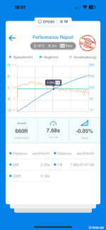

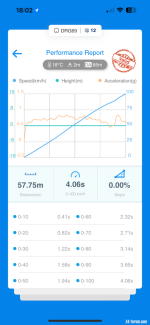

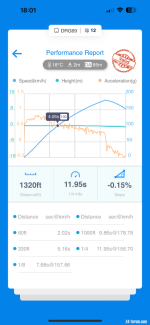

Swapped manual gearbox for ZF 8hp45
Project completed, plenty track days no big issues
Dyno ron98 and e60 blend.
