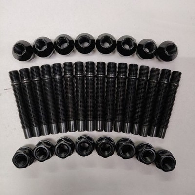

I seem to spend far too much time taking wheels on and off so I thought I'd try some of those fancy wheel studs, hopefully to make the process easier, as everyone says it does.
I'm not fully convinced yet, I actually found it easier to previously line up the 'hole with the hole' and then get a bolt quickly screwed in. A technique I had nailed after many years of doing this.
Now, I need to line up all 5 studs with the wheel, all at the same time. I see the benefit if running spacers.
I'm sure I'll get used to it.
A very nervous first drive, imagining the studs have loosened somehow.
M12x1.5x75mm x 20, with a few drops of Loctite on each of the threads that go into the hub.
Torque up the studs, I went for 30nm.
Let the loctite to cure for a few hours. Then install the wheel and nuts to the usual spec (I go 140nm)
What’s the detail on the studs mate- got a link to them?
Thx
