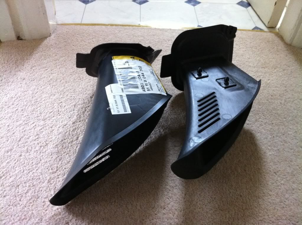

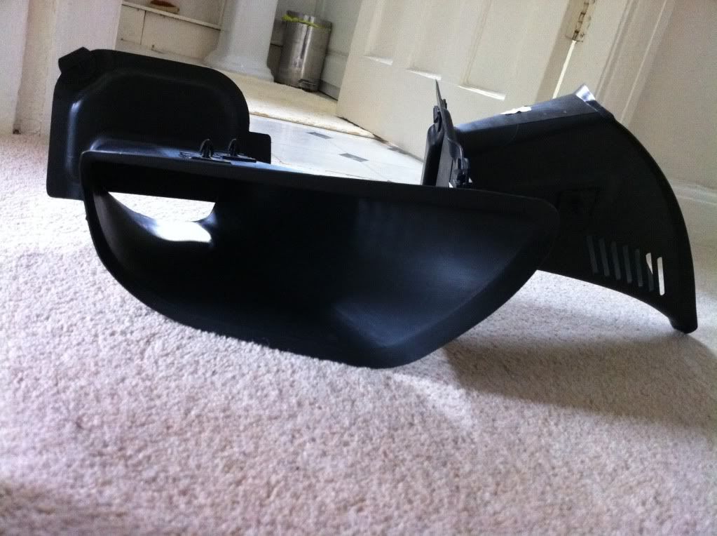

aquazi said:To play devils advocate..... i have just taken a pic of the M ducts lying in my garage:
Wow , fitted carpet on your garage floor :lol:

comments...aquazi said:To play devils advocate..... i have just taken a pic of the M ducts lying in my garage:
They have the back half blocked, and have a vent on the top:
Dont understand the whole increase pressure bit though

If you measure the air pressure inside a brake duct which is partially blanked at the back, you will find that it increases above ambient pressure with increase in speed, so where is the air going then? Think inflated windsock with a hole in the side: does air enter into the windsock through the hole in the side, or does it escape from inside the windsock through the hole?BMWZ4MC said:And I shall play Devil's advocate even more by suggestive that since the brake duct is of reducing radius, as air passes from the open mouth at the bumper to the half-blanked exit in wheel arch that air must accelerate. The consequent pressure drop will actually entrain air through the grills into the brake duct as described so eloquently by Giovanni Battista Venturi :roll:

Makes sense to meBMWZ4MC said:aquazi said:To play devils advocate..... i have just taken a pic of the M ducts lying in my garage:
exdos said:If you measure the air pressure inside a brake duct which is partially blanked at the back, you will find that it increases above ambient pressure with increase in speed, so where is the air going then? Think inflated windsock with a hole in the side: does air enter into the windsock through the hole in the side, or does it escape from inside the windsock through the hole?BMWZ4MC said:And I shall play Devil's advocate even more by suggestive that since the brake duct is of reducing radius, as air passes from the open mouth at the bumper to the half-blanked exit in wheel arch that air must accelerate. The consequent pressure drop will actually entrain air through the grills into the brake duct as described so eloquently by Giovanni Battista Venturi :roll:
Lower said:To generate a ram air effect the duct would have to widen rather than taper. To create a static pressure you would need to slow the air down rather than accelerate it, which is what this duct would do.
An F1 airbox is a prime example of this. Relatively small air intake, opening outwards thereafter.
