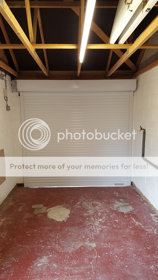

I got a rubber strip but the floor is out so will just need to level it.pvr said:Mine has a rubber flexible bottom strip that is attached, that would work for yours.
What is the headroom used in the end?

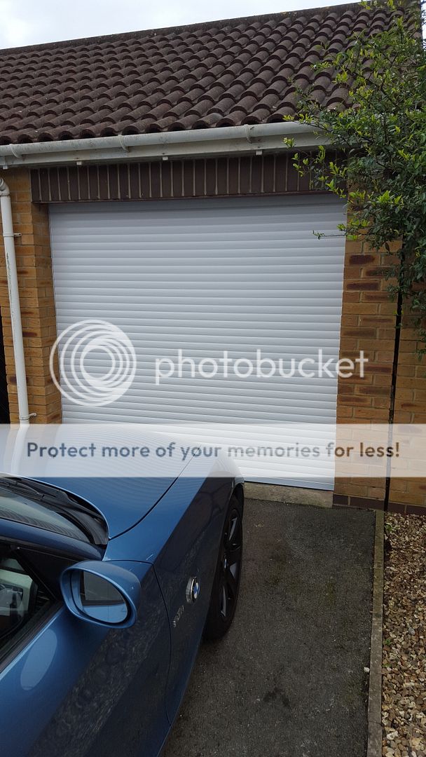

So far so good. Was £395 plus £60 delivery. You pay for it then give them measurements and they build it to order.ben g said:Nice one Dan! Looks lovely. How much was it? Your garage looks about the same width as mine, I think.

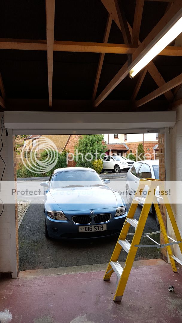

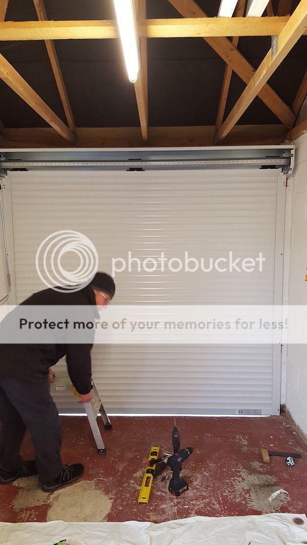

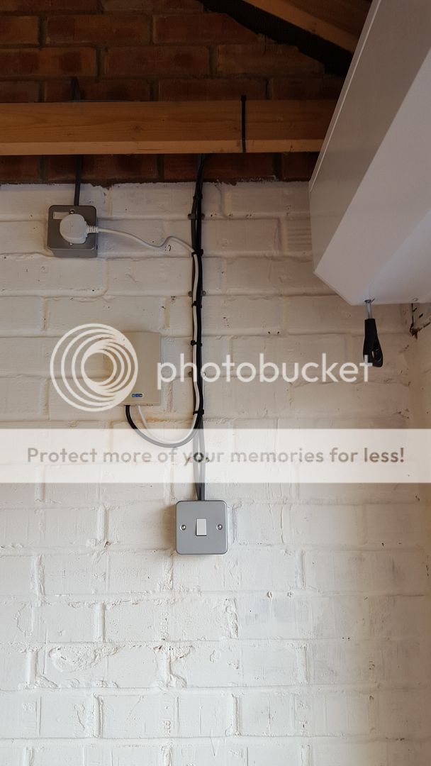

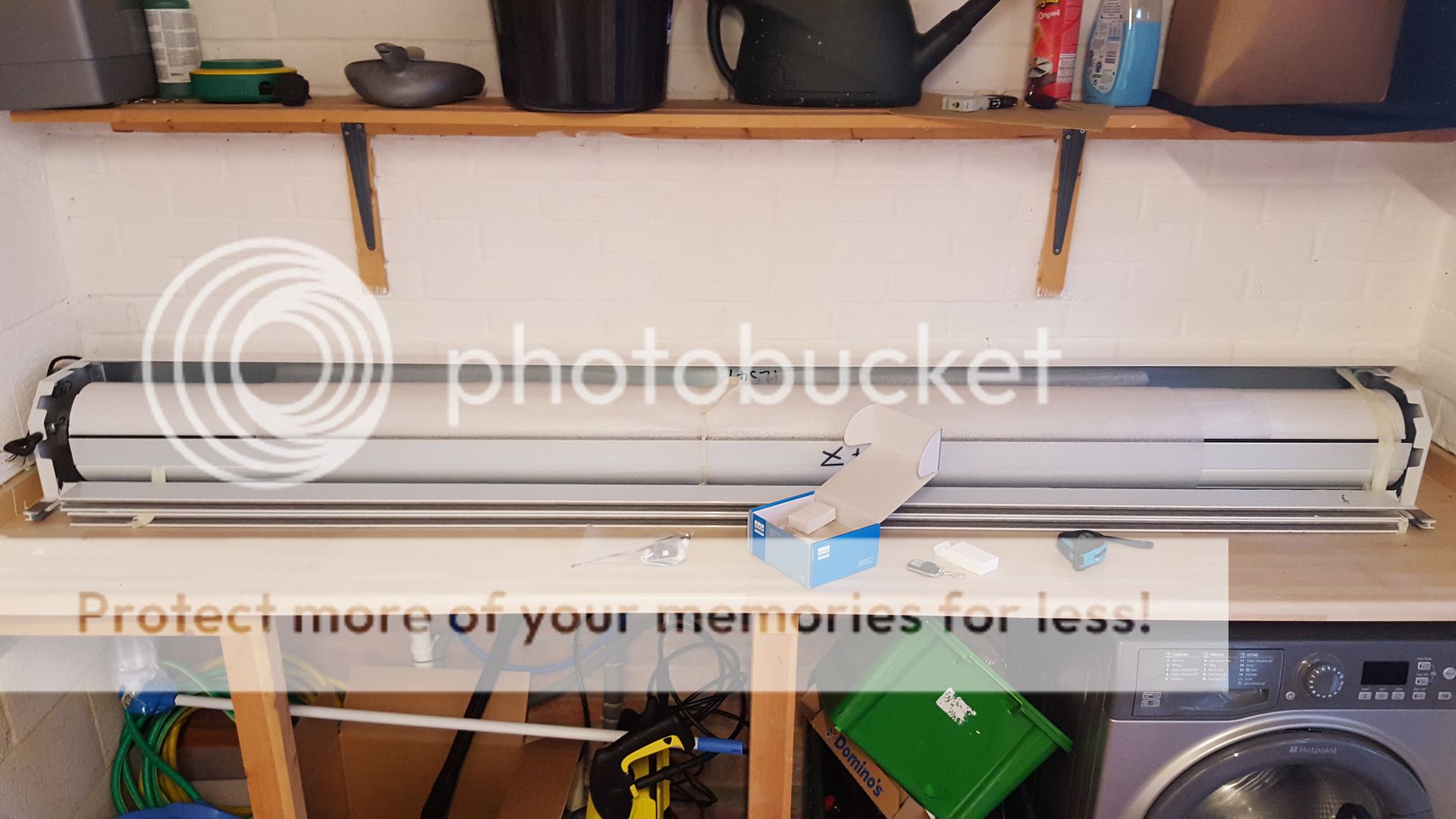

Sorry pvr just read what you said again the box which holds the roller door needs 205mm was easy to fit took about 3 hours with my dad. Surprised at how easy it was the wiring was straight forward.powers fed off a plug with a 5A fuse which I've fed it's own socket for off a 16A mcb B type. The runners either side come as a standard length which you cut to length if your floor is uneven as mine was. The door is priced at £370 now! I'd say it's a bargain they have great reviews and sold slit of doors.pvr said:Mine has a rubber flexible bottom strip that is attached, that would work for yours.

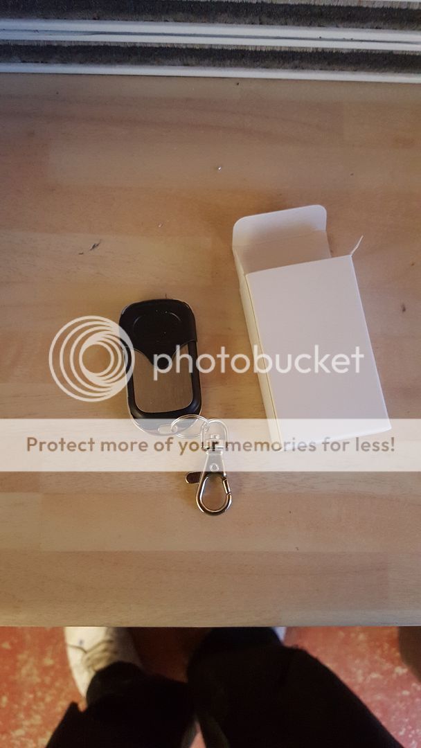

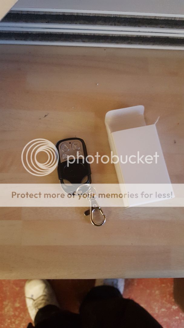

Do you mean a digital input to send a open and close signal via a separate circuit? I don't think it does but haven't really looked into it tbh.pvr said:Is there a manual pulse override in the control unit inside? I need to wire my control unit that connects to the phone app to that.
Switches on the rhs but they're soldered onto the circuit board.pvr said:How do you open yours from the inside or is it remote control use only?
