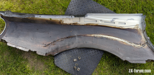

I removed both front wings, and found more of the weird scabs on the front chassis legs, so treated those the same as the rear quarters got, but not much else. I lost my work area over the summer due to house improvements, and didn't want to work on the driveway out the front of the house.
Hopefully over winter I'll crack on and get the rear subframe dropped, and all the bushes etc. replaced.
