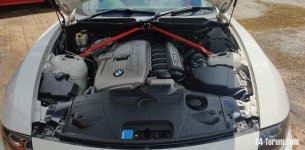

The old 2.0i engine

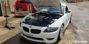

Old 2.0i engine ready to come out:
All out and ready for new engine:
New engine in but still needs wiring and plumbing in:
And finally in and all running: (the broken plastic engine cover is only temporary)
