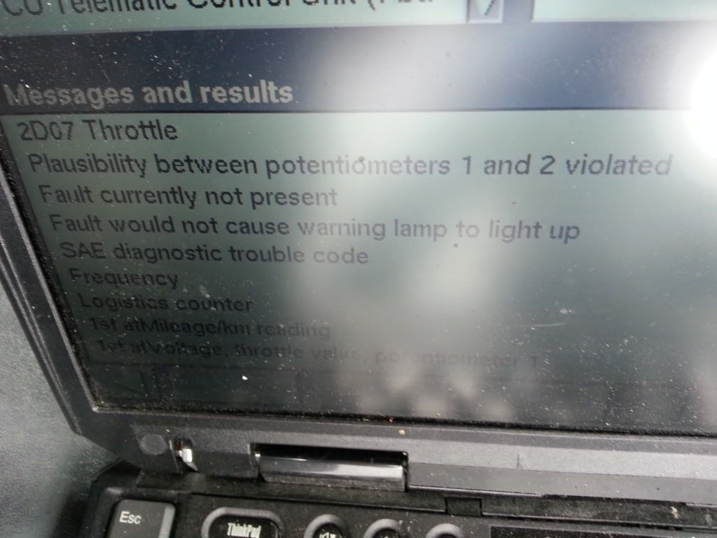

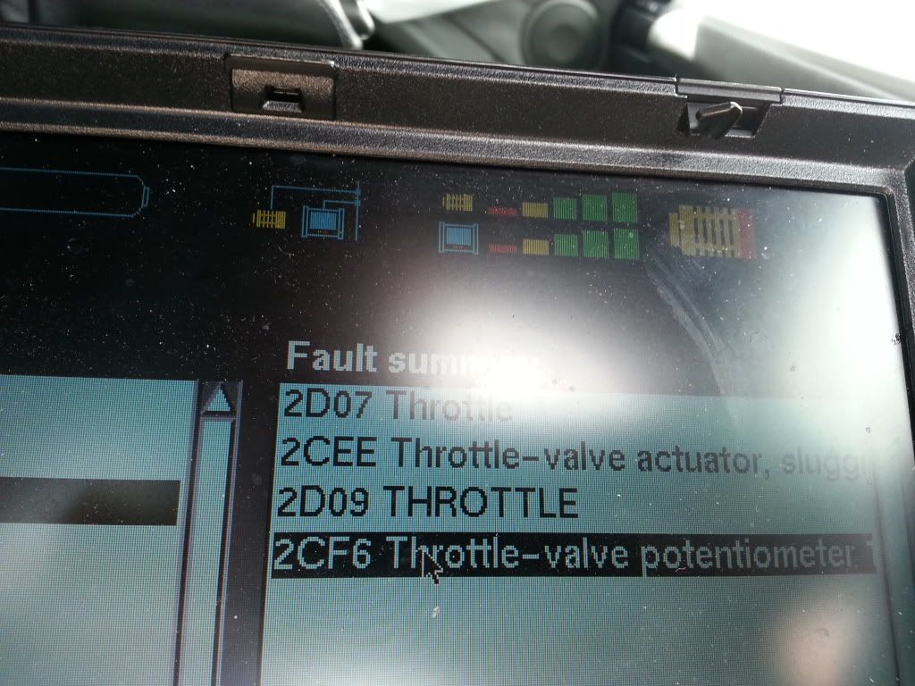

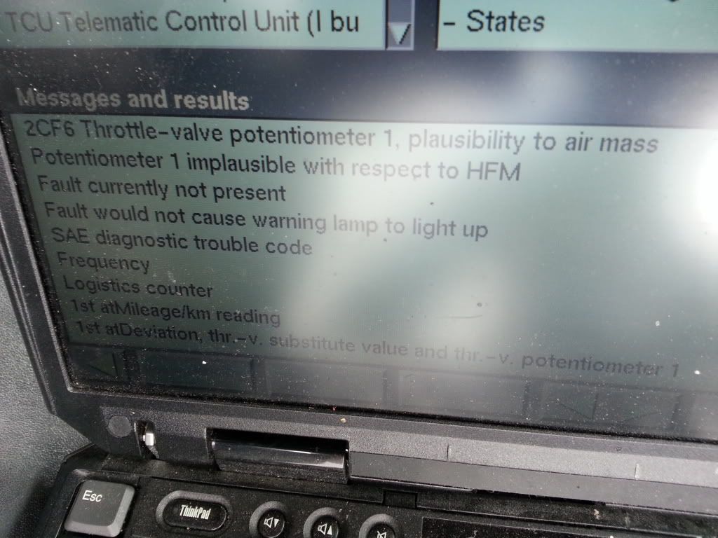

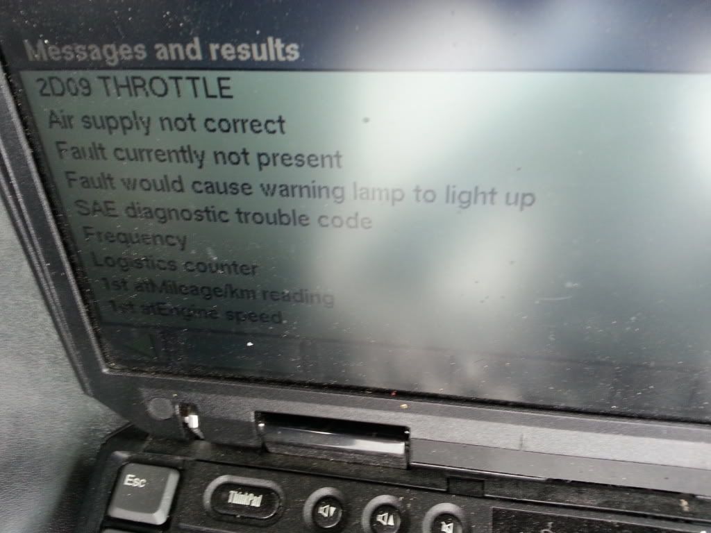

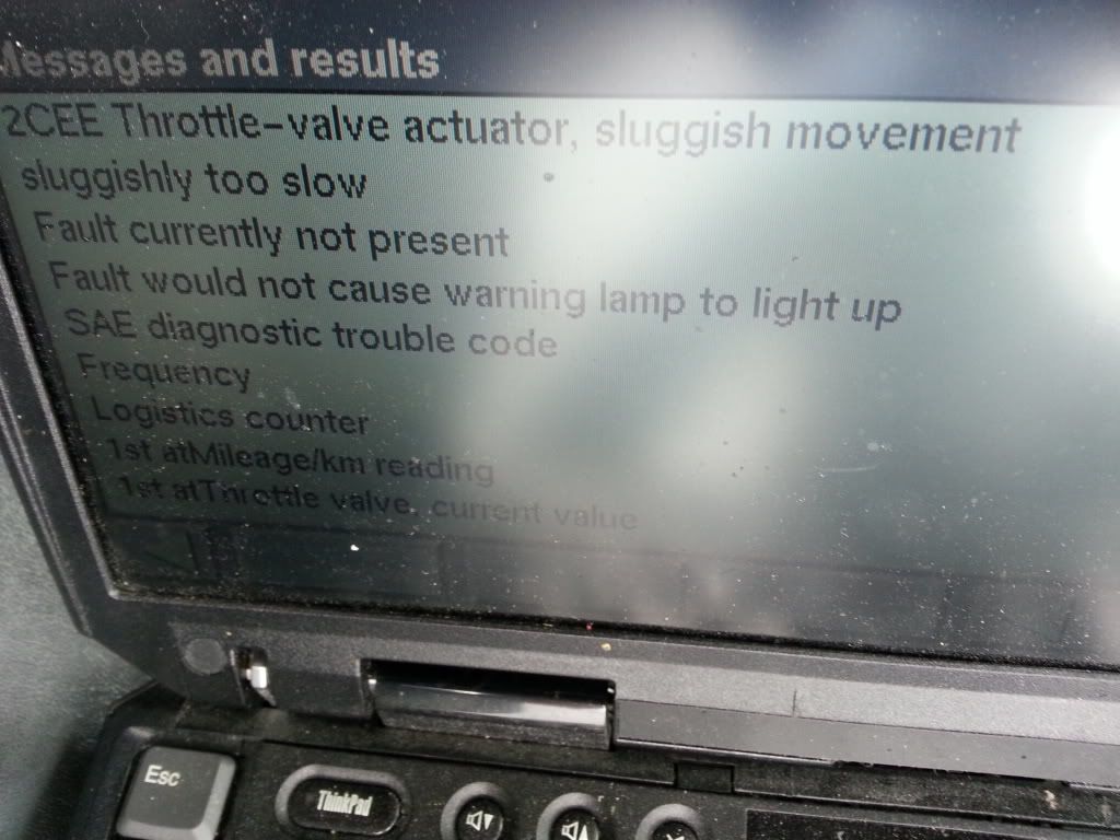

Not an easy one to diagnose..
But fault codes are only the start of the diag trail.... Live data needs to be seen to see what is going on when the fault occurs..
What is weird is the DSC/EML light light on at the same time.....
If you would want my guess i would say MAF sensor...
