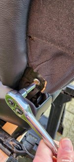

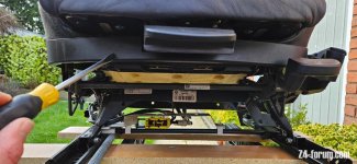

Okay, thought it would be straight forward to get out but there is a bit more to it so here goes:
Remove covers both sides of the seat back
Remove bolts both sides
Seat back will then pull up and off with a wiggle. If you have heated seats unplug the blue plug underneath the seat and feed the wire up through when pulling the back up and off

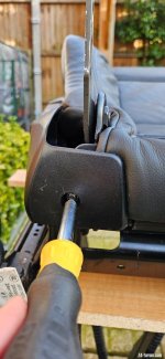

Remove screw

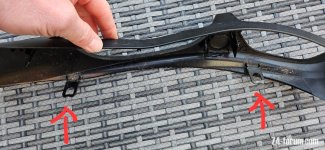

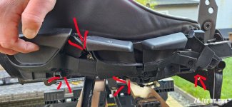

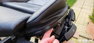

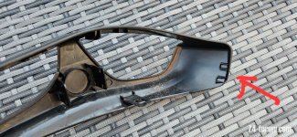

Now remove the side plastic, easily to show with it off so you can see the tabs and clips

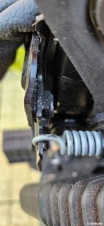

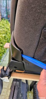

Unclip the front tab with a flat screw driver
Unclip the 2 bottom tabs

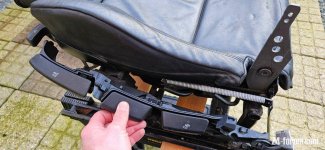

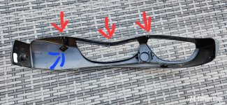

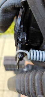

Blue arrow points to a hidden tab to lift and unclip, red arrows show areas you lift up and over and then off.

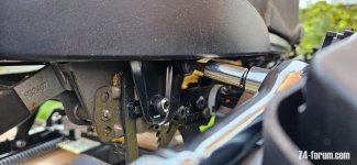

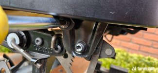

With the cover off there are 4 bolts to remove, 1 gold and 3 black
Side unbolted, just let it hang there as the seat slide lever is still connected

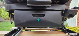

Remove the first aid box, open the flap and inside is a tab you push up at the front, centre and then pull forwards
Remove this trim

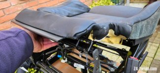

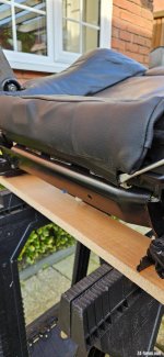

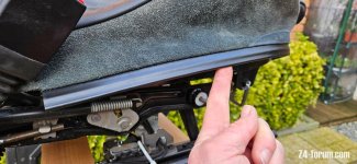

Remove the seat base trim on the left, start from the back (seat buckle side)
Side removed
Do the same the other side

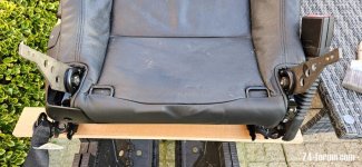

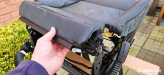

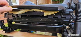

Unclip the seat back
Like so

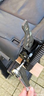

Remove the 2 bolts from each side, should have white paint on them
Next to each of the top bolts either side there is a metal tab
Straighten them both
Now the back of seat should lift up

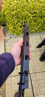

Grab the metal and rotate clockwise and pull it out
With the metal piece removed. Yours obviously won't have isofix hooks on it.

Thanks Usel for these instructions - just fitted on in my electric seat. The only difference I found was for the gold screw. The screw was partially obscured by the seat base - I think if the front of the seat base was tilted up prior to removing it from the car it would’ve been easier to get to.
