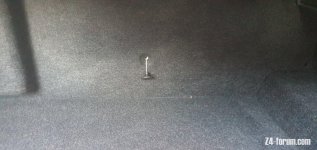

1) Remove battery cover floor panel.
2) Remove the two plastic retaining screws holding in the carpet where the boot ‘steps’ up.
3) Pull back carpet to bulkhead.

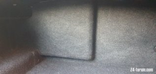

4) Lift out right side trim panel enough from the bottom and place something sturdy underneath to keep it held up (this requires a little force once you’ve push-released the trim tabs that fold into the rear bulkhead section)
5) Repeat this step on the left side, being careful not to damage the trim. Wedge this side too.
6) You should now have a gap almost the back bulkhead of around 10cms to root around in.
7) Cables should be somewhere in the centre. Get your hand up and into the recess behind the rear centre console. For me, thats where they were.
My entire attempt at this has been a balls up. I got to step 6, but cannot see how you managed the bottom half of that photo? After pulling out the carpet screws on the bottom piece (15 minutes of "unscrewing" got now where so I ripped the out) I propped up the two side panels with cups this is what mine looks like:
But the problem is my bulkhead carpet piece is rigid just like the floor piece covering the battery! I manage to pull it out a bit but only enough to get a finger in. I can feel the bundle but cannot see or get at anything. What did you do to actually get the bulkhead carpet up?!?!? :headbang:

Major Mojo: man that sucks. Step 6 is the really difficult part. Feels counterintuitive to pull the edges of that rear bulkhead trim up (the rigid horizontal bit behind your mugs in the picture you posted), but it does go and you need to wedge something under it very quickly.
Just needs some force in one corner then the other. Helps also if you can pull up and away those side panel trim bits you currently have the mugs holding up. Just the one side works to get things moving.

Ive seen a different install method which requires removal of a ton of trim pieces in order to reveal the trunk back wall where the amp etc is. This method above seems much more straight forward.. however, forgive me for being a n00b, but how do you remove the plastic 'screws' or 'buttons' that hold the carpet down? Ive been trying to lever them up with a trim removal tool but they wont pop so readily and Im worried im going to shear their heads off. Any clues?
