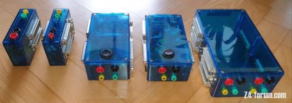

For the following BMW convertibles, the Y3 tool got finished (K1..5 are these blue concentrator boxes):
K1: E89 - Z4 Roadster
K1: E93 - 3-series convertible
K2: F33 - 4-series convertible
K2: F83 - M4 convertible
K2: F91 - M8 convertible
K2: G14 - 8-series convertible
K3: E46 - 3-series convertible
K3: E52 - Z8 Roadster
K3: E64 - 6-series convertible
K4: E88 - 1-series convertible
K4: F23 - 2-series convertible
K4: F12 - 6-series convertible
K4: R57 - Mini convertible
K4: R59 - Mini Roadster
K5: G29 - Z4 Roadster
K5: G29 - Boldmen CR4 https://www.boldmen.de/en/
K5: G23 - 4-series convertible
K5: I15 - i8 Roadster
K5: F57 - Mini Cabrio
All 5 concentrator boxes (K1...K5) got completed in between, as well as tested with at a minimum of one model.

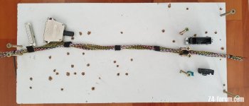

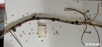

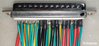

The above named concentrator K6 for the elder Z4 E85 & Mini R52 has been completed as well.
A completely new interface cable for the 14+6 pole connector had to be built as well as the BlueBox K6.
Have a look at the development process of this Y-cable:
20 wires forth plus 20 wires back
Additional 1.5mm² wires to control the motors
Voila, Germany's Next Y-Cable. 8)

Update 11/2022:
For the following BMW convertibles, the Y3 tool got finished (K1..6 are these blue concentrator boxes):
K5: G83 - M4 convertible
K5: xx - reserved
K6: E85 - Z4 Roadster
K6: R52 - Mini convertible
All 6 concentrator boxes (K1...K6) got completed in between, as well as tested with at a minimum of one model.

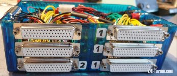

Upgrade process of the K5 BlueBox to integrate the new 4-series convertible:
Before starting
Opening of the BlueBox
While soldering the additional wires to the G23/G83 plug
Integration completed
Ready for testing
Re-mounting all plugs
Top view

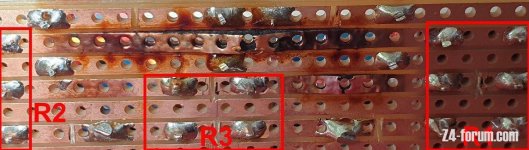

Arrgh, during a test session on an older Z4, here's what happened to my new addon interface box for the front locking systems:
Melted conductor tracks on the circuit board.
I had to redesign the complete unit and added an electronic overload protection (shunt, transistor, relay) to timely shut down this unit if a short circuit or current overload occurs on the front locking system. This additional group was placed on the left:
My test environment with 3 different front locking systems: E93 , F33, E89
