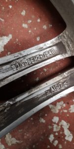

Evening guys. I’m trying to figure out some options for my 2.0i. Currently I’m on 19” rims with run flats which I detest. Ideally I’d like to lose the 19s and go to 18s but with a good strong offset and normal tyres.
Fronts are 225/35/19
Rears are 255/30/19
What I can’t figure out is the offset. I’m looking for an ET number but the nearest number that looks right is an IS number. Can anyone identify from these pics what the offsets are? Also I can make out that the fronts are 8” wide but can’t make out if the rears are maybe 9”. They fill the arches quite well but I’d like to go a little bit more aggressive. Any feedback much appreciated :thumbsup:

Yes, BMW call it "IS" on their wheels but most others call it "ET".
I had a set of E89 staggered 18" 295s on my E86 that I just sold and they were 8J ET29 fronts and 8.5J ET40 rears, so very similar to what you have. But on an E86 they really sat well out in the arches.
When you say a bit more aggressive I'm assuming you want them to sit further out, so you need to look for ET/IS numbers lower than what you have, or think about fitting spacers to get the same effect.

Your wheels above are style 326 so the numbers are
Front 8j et 29
Rear 9j et 40

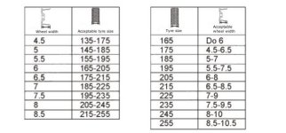

wheel and tyre widths according to TÜV - after market takes advantage of the range
