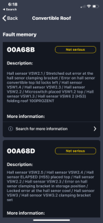

00A68D is the hall sensor code, I got a new one, unplugged all hall sensors until one didn’t change that code, or add more, so I changed that sensor, no change my top seems like it’s about to fully close but when it’s about to put the last part down (glass part) it stops and dings.... so I started to check continuity and all sensors have good continuity until I get to the red wired sensor on the lower hall, however I ran the red directly with it’s brown match (they are on top of each other with the other sensors) and all but this one are good... but neither the red or brown have any continuity on any wire... sooo I am in of the pinout at the module to see which pins work the hall sensors, at the plug they are all close together.... so it’s strange
