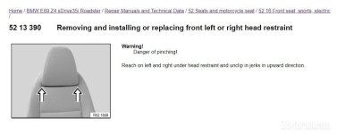

To return the thread to heated seats somewhat - does anyone know how to remove the headrest from the MSport seats so I can start “skinning” the seats please? :oops: :D

Well according to the workshop manual....

Thanks Dave - so essentially its "just" pull upwards in a jerking motion. I wanted to be sure there was no clip or bolt I needed to undo first. I'll give it a go and will report on progress :)

I can confirm that grabbing the headrest firmly and one or two quick tugs and off it pops! 👍
