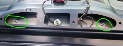

You will see the two 8mm nuts, remove them -- they are less than 2nm torqued so they will almost unthread without a tool.

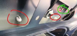

Open it back up with the wedge in place...and remove the wiring connector. Use the pliers to compress the clips. With the wedge pressure they will pop release with a very satisfying sound. Take a sip of that beer - hard part is done.
