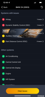

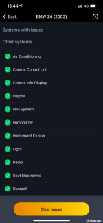

Diagnostics show no errors, apart from ones I already knew about (wheel sensors and airbag wiring problem).
Opinions? Still likely to be GM5 or something else??
