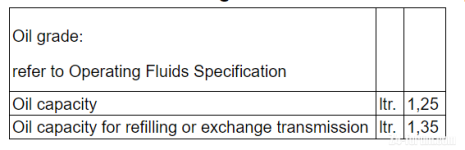

Same as any other gearbox really. Undo fill plug followed by drain plug (not the other way round), one underneath, one up on the side. Put drain plug back, wangle oil uphill into fill hole[1] until it starts coming out again.
Box takes about 1.5 litres (can't remember spec.)
[1] Choice of using the 1l squirty bottles with pull out nozzle the oil comes in or a long length of pipe that fits in the filler and a funnel attached to the other end.

Just done my gearbox oil.
17mm socket with extension and I struggled to loosen both plugs - not sure why these were so tight.
For me it was just shy of 1L to drain and I put whole liter back (minus tiny spill) - I had car slightly tillted up from fill plug side, so potentially 200ml was sloshed to side.
