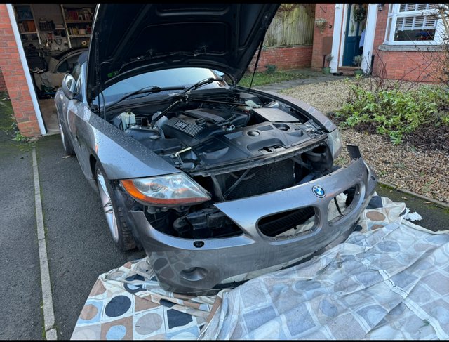

Well, got round to doing mine today. Thanks to all who posted on this thread, was pretty straightforward. Wish I could say the same for the wing which I’m replacing too. Had to take an angle grinder to the wing to get to torx bolts which won’t budge, hopefully PlusGas does the trick! It came in handy for one stubborn engine bay bolt, would recommend having a can of PlusGas to hand for these 20 year old fixings.
Now need to get some side skirt clips ordered too as partial removal or skirt is needed to access bolts for wing removal.
Am going to take my bumper, wing and side skirt off as I think someone has replaced them at some point, badly. The gaps are big and the bumper is on loosely and looks rubbish.
I have seen some fixings kits on eBay, which ones would I need as I would ideally like to be at least semi prepared before I take everything off rather than have it sitting for a week naked on the drive while I wait for stuff to arrive?
