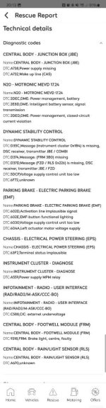

Please see below a screenshot of all the error codes.
Any advice will be much appreciated...

A fully depleted battery will never ever be able to be used again..it may be so bad that even a jumped battery fails to bring the voltage rails up enough for systems to work..
So brand new battery, fully charged, then attach to the car, clear codes, see what gives …don’t forget to register and if necessary code the battery..
Would be a good idea to see what the root cause of the initial battery drain was once you get things to go..otherwise history will repeat itself,

Thanks for your reply. In the end, I recovered the car to a local BMW specialist. What happened was that water had managed to find its way to the botton of the boot, mostly through the long seal at the top (which I had tried to repair a while ago). The water damaged the EMF control module and that's what was causing all the issues: parking brake switch light being constantly on after locking the car and subsequent battery drain.
They removed the bumper to seal vent. They had to replace the EMF module, replaced the corroded plug and all wire terminals. They also fitted a new rear boot seal and a new battery.
My wallet is still smoking after paying the repair bill.... but at least it's all good now. At long last I can drive it again!
