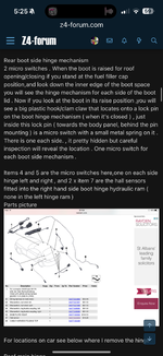

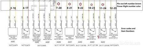

The two microswitches are in the same location roughly as the hall sensors you found the connection on
The boot needs putting in service mode
The roof needs to be partially open with the rear boot lid open so you can see the two ram arms either side of the car
You should see the microswitches and wiring then
