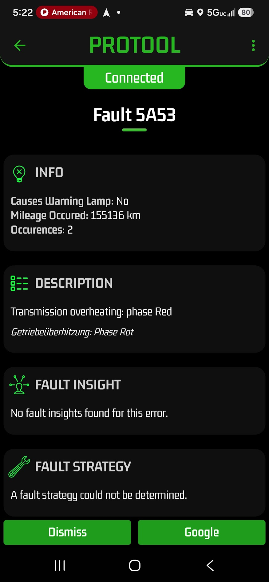

Fault 5A53 : Transmission overheating, phase red, black
Christopher72
Active member
 Ohio
Site Supporter
This hit twice this week iu 75F weather on a light drive... So... :poop:
I have an indy that is going to systematically check temps to trace the problem next week, but ugh.
I've done transmission service 2 years ago, it tripped in july last year and the stealership just cleared the codes without any work on it.
Hopefully this wont be too painful.
Usually it’s a low fluid issue..or just occasionally a rogue ‘blip’

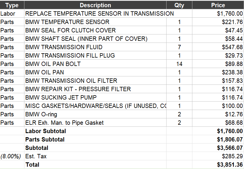

Took it to a European specialist running ISTA+ and they actually did a proper root-cause workup. Turns out the culprit is the combination RPM/Temperature sensor (p/n 28107842851) — one unit that reads both input shaft speed and fluid temp, and it lives deep in the bell housing. When it starts drifting, the DME sees overtemp conditions that may not reflect actual fluid temps, which is why just clearing the code (or even a fluid change) doesn't fix it.
Getting the sensor out means pulling the transmission, so while it's apart I'm doing a full service plus everything you'd be crazy not to do while you're already this deep:
Transmission service (primary repair):
  • Combination RPM/Temp sensor — p/n 28107842851
  • Clutch cover seal — p/n TBC
  • Inner shaft seal — p/n 24137546665
  • Pentosin DCTF-1, 7 liters — p/n 83222147477
  • Internal oil filter — p/n 28107842828
  • Pressure filter repair kit — p/n 28107842840
  • Sucking jet pump (scavenge pump) — p/n 28107842838
  • Oil pan — p/n 28108070791
  • Oil pan bolts ×14 — p/n 28107842386
  • Fill plug — p/n TBC
  • Misc gaskets, hardware, seals

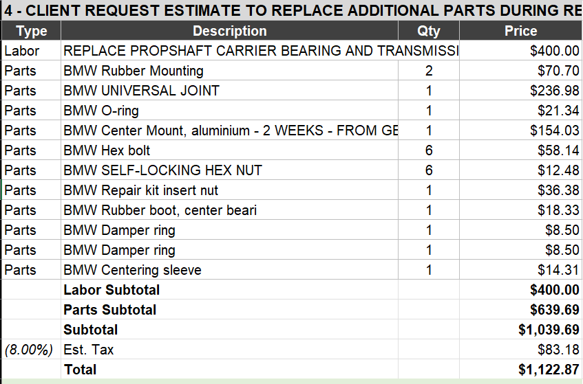

Preventive driveline work while accessible:
  • Harness connector O-ring — p/n 28607849555
  • Transmission mounts — p/n 22316799331 (×2)
  • Flex disc / guibo — p/n 26117610061
  • Guibo bolts — p/n 26117527475
  • Guibo nuts — p/n 26127536563
  • Center support bearing — p/n 26121225071
  • Center support carrier bearing — p/n 26127572932
  • Propshaft repair kit — p/n 26117567770
  • Propshaft rubber boot — p/n 26117526628
  • Propshaft damper ring — p/n 26117581110
  • Front driveshaft bolt — p/n 26117635643 / nut — p/n 26117523709
  • Rear flange bolts — p/n 26119454792
All-in quote ~$4,892. Steep on the surface, but the bell housing labor plus a comprehensive driveline refresh justifies doing it all in one shot.
