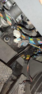

Splendid! Thanks for taking the time to reply in detail! :thumbsup:
I'm going to try without removing the seat and steering wheel. Does the lower column plastic cowling come off without removing the steering wheel?
Thanks again mate, greatly appreciated!

Well good luck with that! You're obviously a lot more bendy than me :D
If you pull the steering wheel adjuster down you'll find a screw underneath it. I think there's one other? Then it just pops off.
Get yourself an 8mm ratchet ring spanner and a torch. The rest is easy (says the man with the sprained back and the nervous twitch! :rofl: )

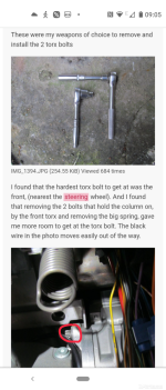

Yup, torx head but easiest to remove with an 8mm ratchet spanner. Far less room needed.
Might sound stupid, but how does an 8mm ratchet spanner fit onto a torx head bolt? :|
jamesdi said:
Easily :wink:
Best bit is, the thing is only a few mm wide. Should be a bi-hex (12 points) to do it though. I use Halfords Professional.
By the time you stick a torx socket on a ratchet handle you need all kinds of space to fit it in.
Check out Portculis and his active thread on it. He found it worked well.
enuff_zed said:
Easily :wink:
If you are referring to the bolt circled in red, that is actually an inverted torx head bolt...
