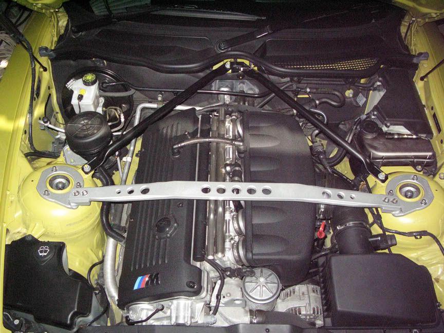

I like the ACS strut brace on my coupe, although I can't quantify how much of a difference it makes as it was on the car when I bought it. Lucky really as I believe they are silly price like most Schnitzer stuff seems to be. Apologies, but the pic seems every so slightly fuzzy.
Your pic is perfect ! Looks great , when I get mine I will post a pic as well , wonder how many different versions of the strut brace there are and difference in price ? It looks very very clean under that bonnet IMHO.
