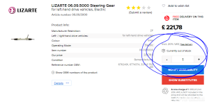

Autodoc sells a LHD rack by Lizarte for £222.15. including VAT :thumbsup: You will need to return your old one though. It says free delivery but may only be the UK. Sorry if we have been here before but it is a long thread and I may have lost the thread.
Yep, all of them are out of stock. Checked if that's actually the case too by calling the companies listed on Autodoc (ERA, Delco, Elstock) :(
