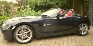

I have had 2007 E85 3.0Si for a few years now and have tolerated the run flat handling for a few years until recently. It is (as far as I know) a standard car with 18" wheels and M-tec sports suspension.
