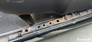

Jamie sent me a pic of where a friend had put it which fits well. The metal bracket attached to the end of the belt bolts between the floor and the rear hole on the runner clamping it securely to the floor. Ideally be nice to fabricate a bracket that clamped under the same hole but came up the side of the runner and then the seat belt could be bolted to that.

I've just pulled the seat forward so you can see..this is looking directly down. It's a temporary fixture until I mount it on a bracket that bolts under the same seat runner fixing but comes up the side of the runner. Its okay here but with the seat right back the runner touches the belt webbing which might cause wear over time :thumbsup:

Ta, thats what I thought... Looking at mine looks like you can grind the rivet that holds the original bracket to remove it then refix onto new runners with a bolt... Might do that instead.

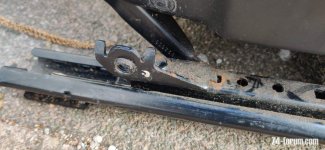

Hi, if anyone is still on here... I have got stuck with the seatbelt bracket that needs to be on the M3 seat rails... Does anyone have advice how to do it please? Best regards,
