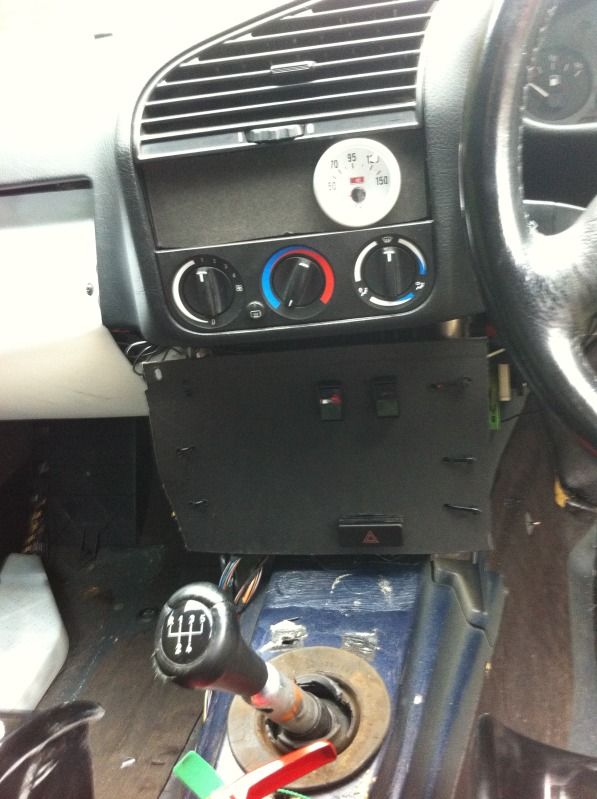

Here is the old panel, its made of cardboard type stuff that went under the glovebox. Wasn't really strong enough to take pull cables etc so made an ally one
Old
New
Its cable tied in place atm cuz i've haven't wired up the cut off yet. Fire extinguisher nozzel pointing at my crotch as well, dont want anything important getting burned!

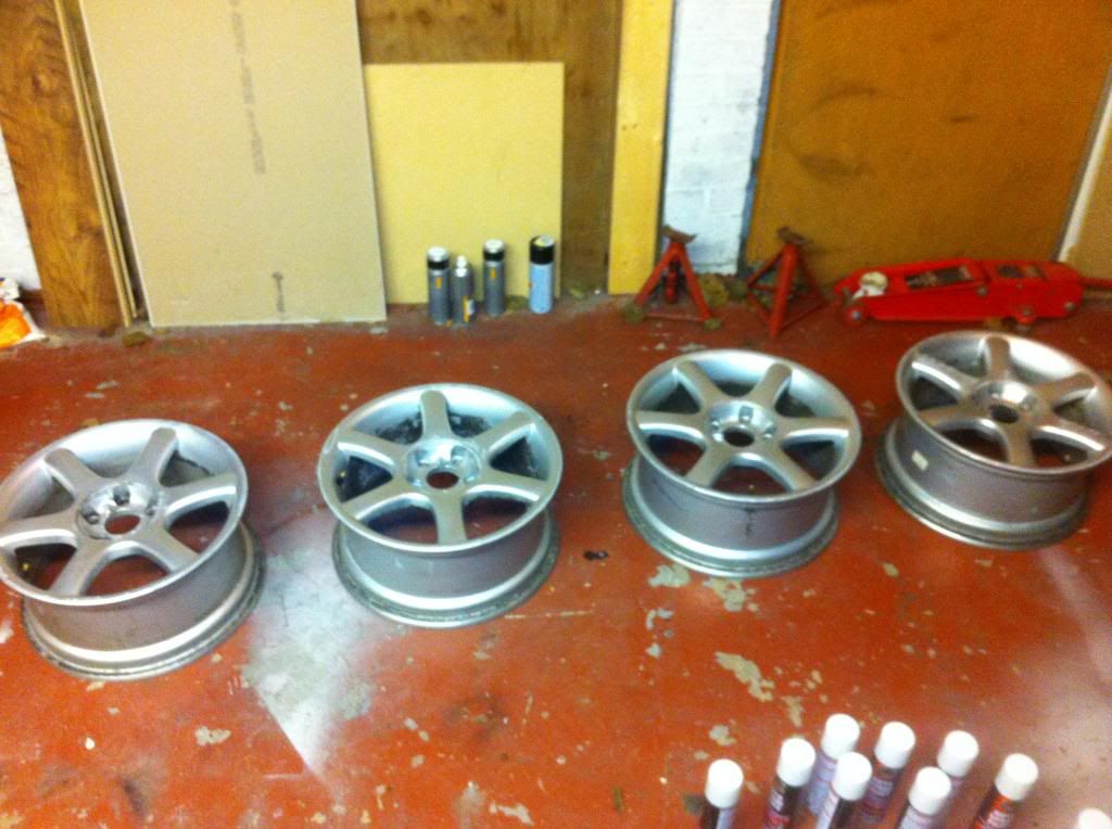

Beginning a respray in white because it was a choice of white or black from the £1 store and white and blue works better I recon, and also easier to clean. I bought a £10's worth of paint enough for a respray on both sets.

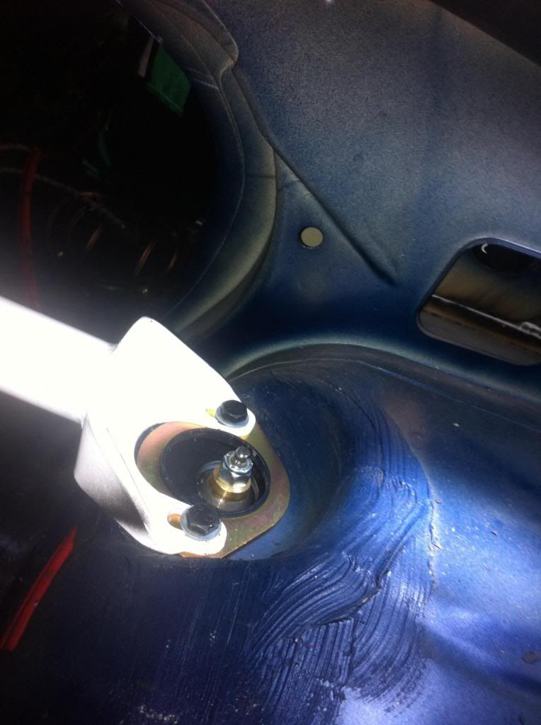

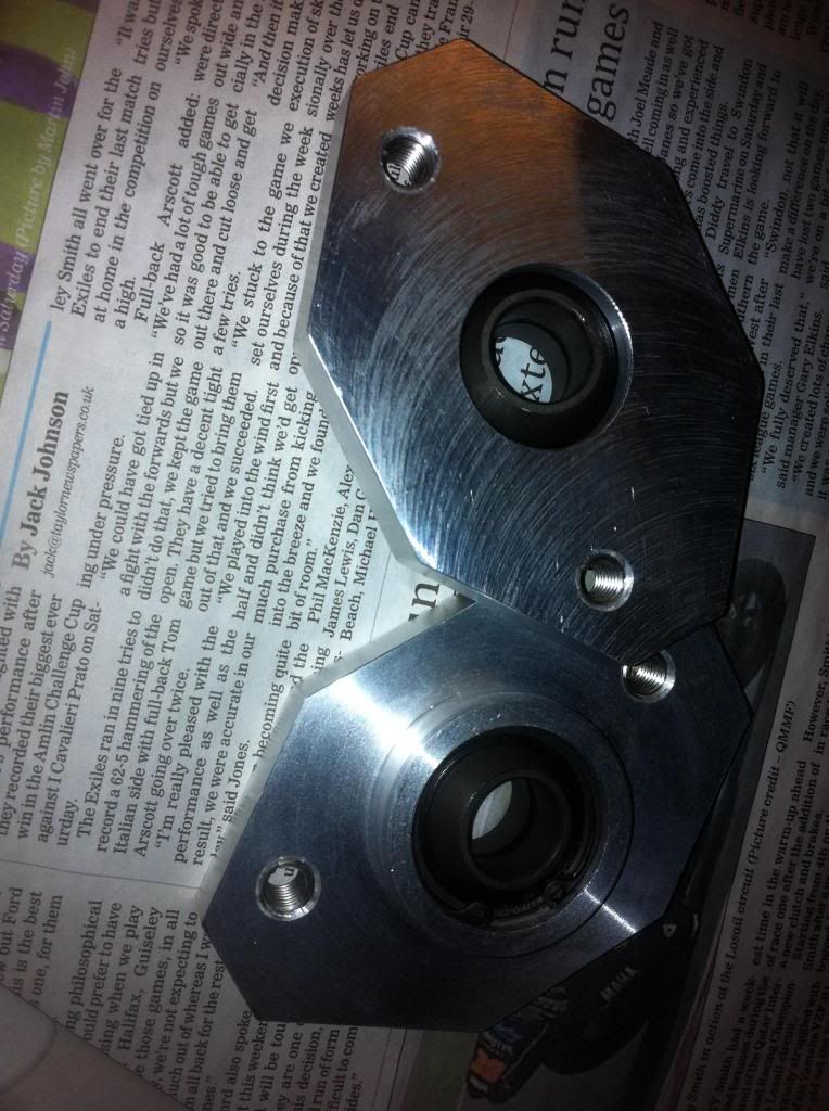

Also had some rear pillowball topmounts made up:
These were fitted with some topmout reinforcement plates & a rear strut brace nice and strong to handle the coilovered rears

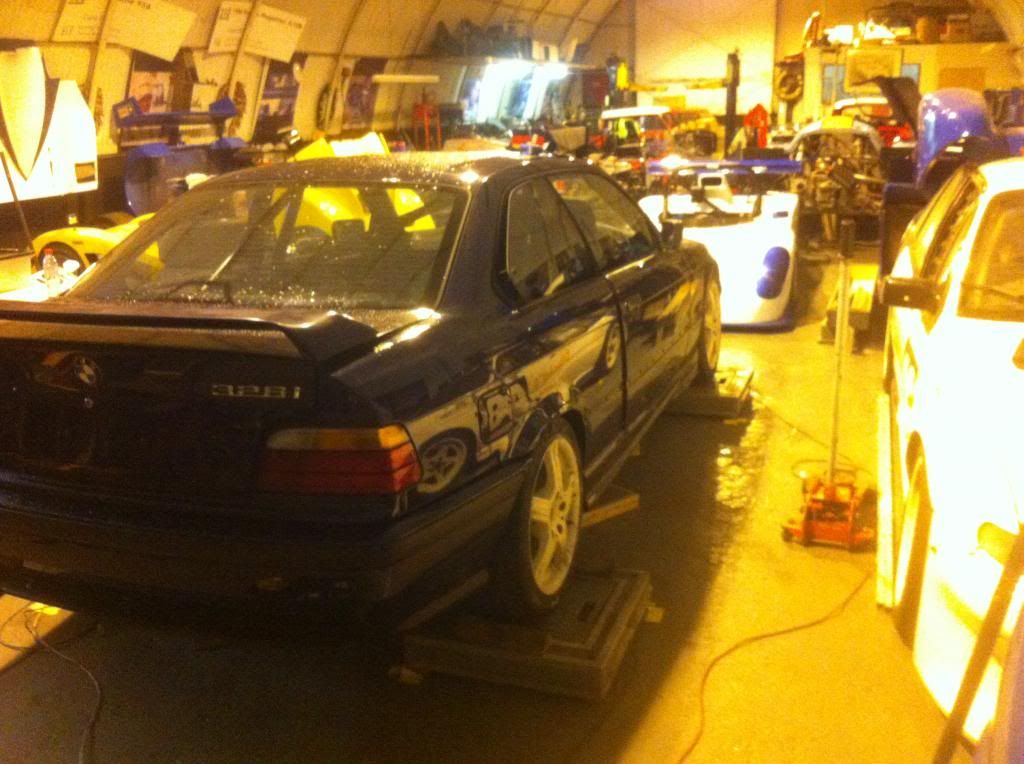

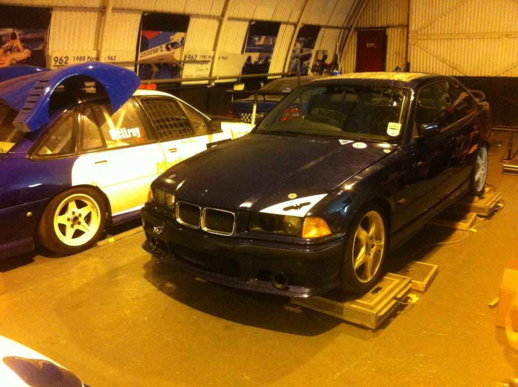

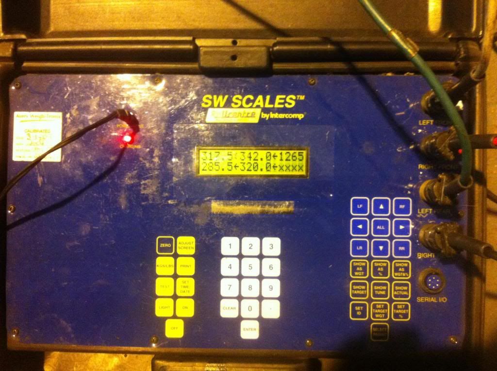

Thats the suspension pretty much done, followed by setting up the geometry at a mates garage. Did the front & rear camber, toe in / out, ride height, corner weighting and front caster

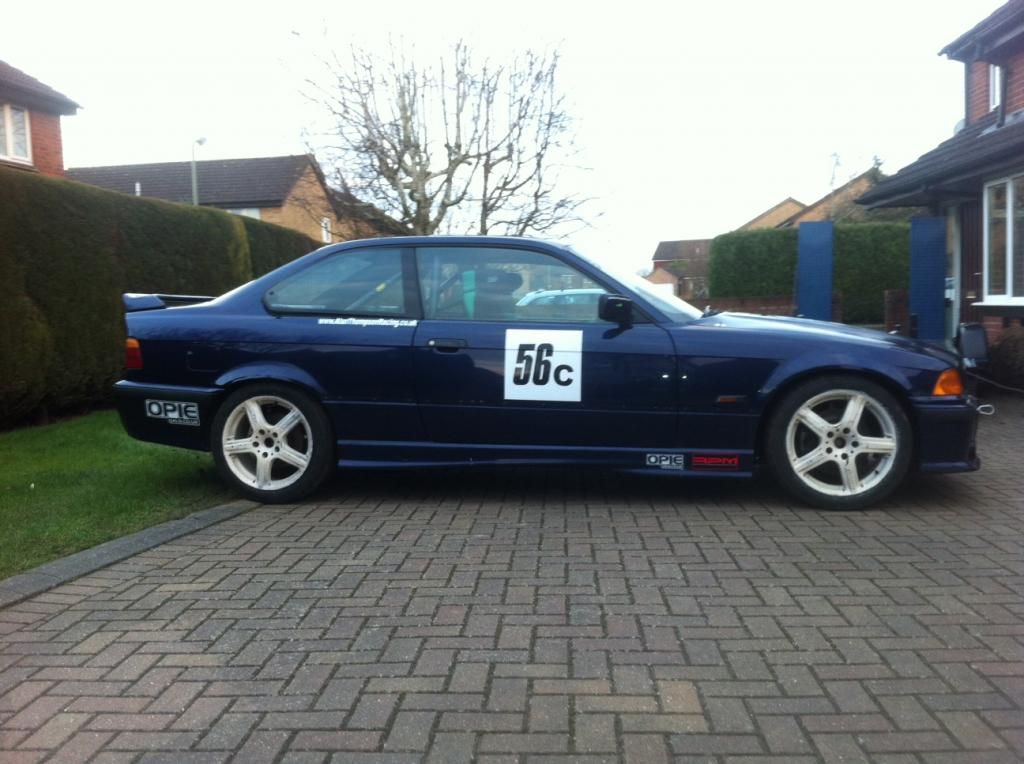

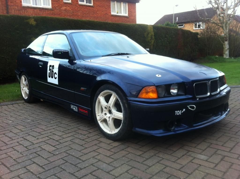

Registered for the Kumho BMW Championship which starts in April and been given the number 56 also been building a website to capture what I'm doing throughout the race season and aid with finding sponsors. Also it means I needed some stickers for my car! :roll:
These are also the Momo wheels (still to be resprayed)

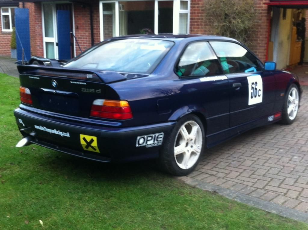

I've also had the exhaust tail peice reworked, points the sound down and also incorperates a trumpet this dropped the noise level from 101 to 94 db. Since the tail peice looks abit diesel style I changed the 328i for a 318d! :D
