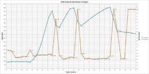

If you refer to my graph (below) of engine RPM versus vehicle speed from datalogging my Z4MC, you can see that in 1st gear the Air:Fuel ratio is leaner than it is in 2nd and 3rd gears, and presumably, this is written into the ECU software to prevent loss of traction when starting in dry conditions. So when it's wet, the driver has to account for the reduced traction available by throttle modulation. Likewise, if you look at a plot of Engine RPM versus speed in any specific gear, you will see that for any given speed there is a matching Engine RPM, therefore there is absolutely no point in flooring the throttle, which might break traction, when instead, you can simply match the throttle position with your right foot to marry the engine revs to the rate of increase of speed by pressing the throttle pedal in a progressive manner through the entire throw until you're at WOT.
