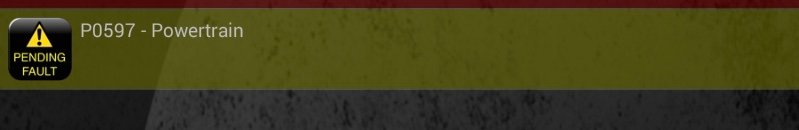

I have the 3.0 N52 with the infamous electric thermostat and water pump.
Using the Torque app, I get a P0597 error code which apparently relates to my thermostat being faulty.
It doesn’t show in INPA and I have no warning lights on dashboard and temp gauge stays bang in middle once warmed up. Car drives absolutely fine and heater blows hot.

My question is - is the car safe to drive, with the ‘possible’ detective thermostat?
Also, any experience on how accurate the Torque app is?
From what I have read if the thermostat has failed, it fails in the safe position.
I have purchased a thermostat and plan to change it along with the pump but was hoping car would be useable in the mean time.
From what I’ve read I should be ok as long as nothing changes regarding over heating.
