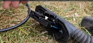

Thought it was worth posting an update if others have the same issue. The door actuator went into deadlock & wouldn't come out. In the end, I had to take the door card off with the door shut which was a nightmare, especially when trying to blindly unplug the electrical connections on the door card. Once I had the door card off, I tried to see if there was anything I could do to unlock the door but there wasn't. There seems to only be 2 ways to get your door out of deadlock, the first is to manually send electric signals to the right wires/pins to take the door out of deadlock and the second method is to drill/break into the actuator so it releases. I ended up manually sending electric signals to the right wires/pins. I had an old car battery that I had recently replaced from another car, I used that & some old wires that were left over from house renovations. You need to send the negative signal to the top pin which is the black wire, the positive goes to pin beneath it which is the blue wire. I will worn that the pins are very close together so it is a very delicate job that you will probably need someone else with you to connect the wires to the battery once you have them on the right pins. If you have a spare door wiring loom, then you can plug that into the actuator & use the end of the wires that plug into the car body to send the signals through, the wires you need are the same (positive to the blue wire, pin 20, & negative to the black wire, pin 21). When the signal has been sent to the actuator, you'll hear what sounds like it unlocking but the actuator will still be in the locked position, you should just need to pull the interior door handle twice, once to unlock & a second to open the door. Please be aware that because the door has been unplugged then the window won't drop down so you should have the window down when unlocking the car, as I had already unplugged the door card, I just put the roof partially down so that the windows went down slightly.
